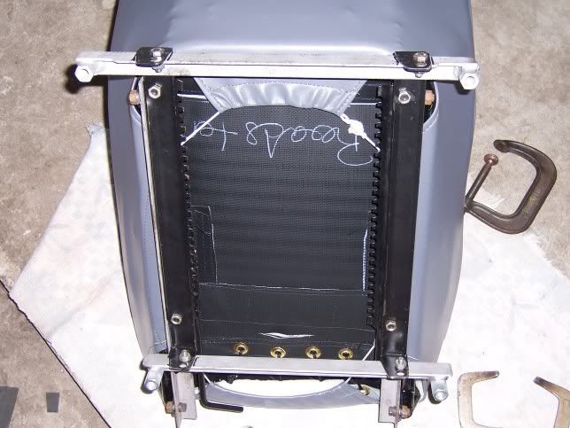

This is how I mounted the seats to my Berrien chassis.  I had the tracks, don't know what they are out of but they are after market and adjust up and down front and back.  I ran angle iron across and welded 7/16 threaded rod splices to the bottom of the front angle.  I drilled a hole through the rear angle and put the splice through the hole then welded it around the hole.  This accomplished two things, it tilts the seats back and gives a nice threaded hole to mount the seat belts to.  I then drilled nice holes through the fiberglass floor with a hole saw and put rubber grommets in them.  The splices fit very nice through the grommets.  I then bolted up through the chassis seat mounts into the the splices.
I hope I explained that well.
This is the kind of stuff I don't think can be accomplished in a two day build.  It took me longer than that to figure out how I wanted to do it, the first idea isn't always the best and then you have parts running.  I'm not trying to be negative, I just think a custom build will take longer than two days to do a nice job.  JMHO
By Rayth O 670 Date 2008-02-21 01:45
I agree on this,  when it comes to fabbing on the fly,  we need to not do that.  Welding would be a problem there too.
