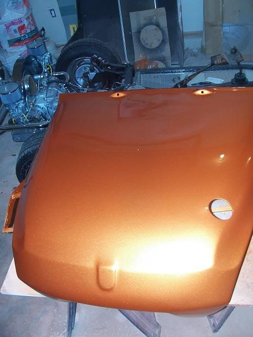

Mine used about a litre of paint. I have another litre sitting in the basement if I need to repaint something. I'm not sure how much clearcoat as I didn't buy it, my buddy who painted the car supplied it.

When I painted my Manx I used Kirker paint. It comes in a 3/4 gallon and you mix it with an activator to make 1 sprayable gallon. Their clear comes in 1 gallon and you add an activator so its a little more than 1 gallon sprayable.
I used just about all of it to paint the Manx, tank, side pods, cage, and other small parts. I may have had a pint of paint left over and very little clear (I use a little more than needed so I can color sand).
