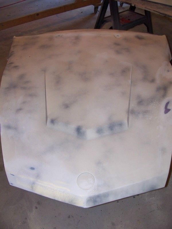

By Jeffrey P 655 Date 2012-05-26 16:16
Nothing like a coat of primer to remind me how bad of a body man I am.

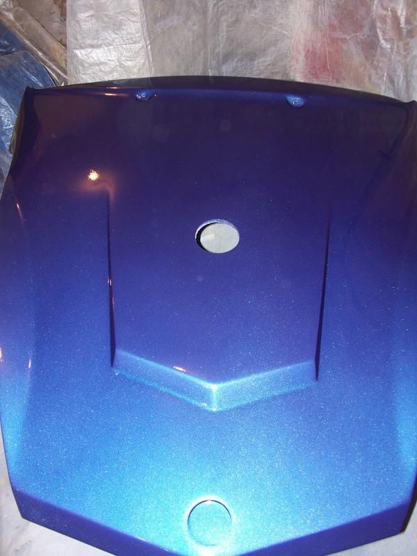

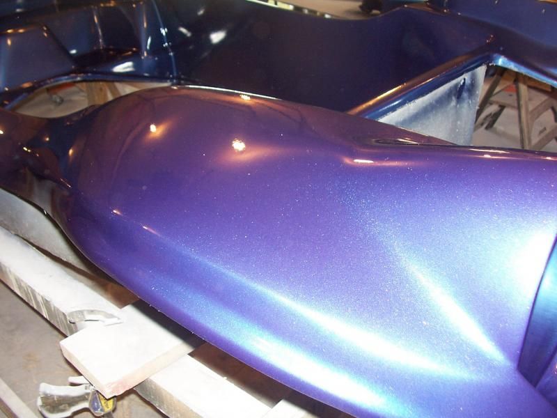

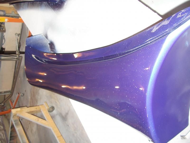

Finally some pics. The little flecks on the parts are pieces of metallic reflecting. As always, they look alot better in person then my terrible camera and poorly lit shop reflect.

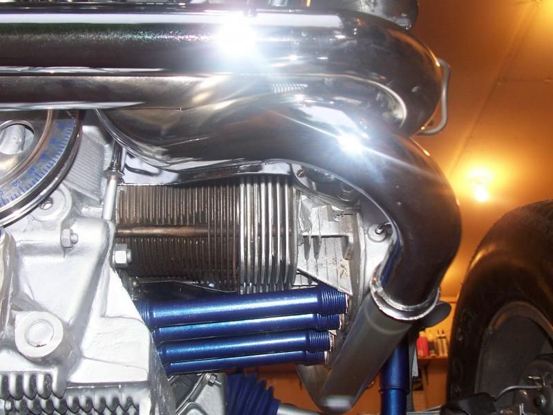

OK...I was asked so here they are. Please pardon all the dust. I have been really busy and I don't have time to give everything a good cleaning. I will before I mate the body to the pan.
Nice and clean carbs!!
I had some leftover cable so I made a grounding strap
I still need to touch up a couple of places with the Herculiner.

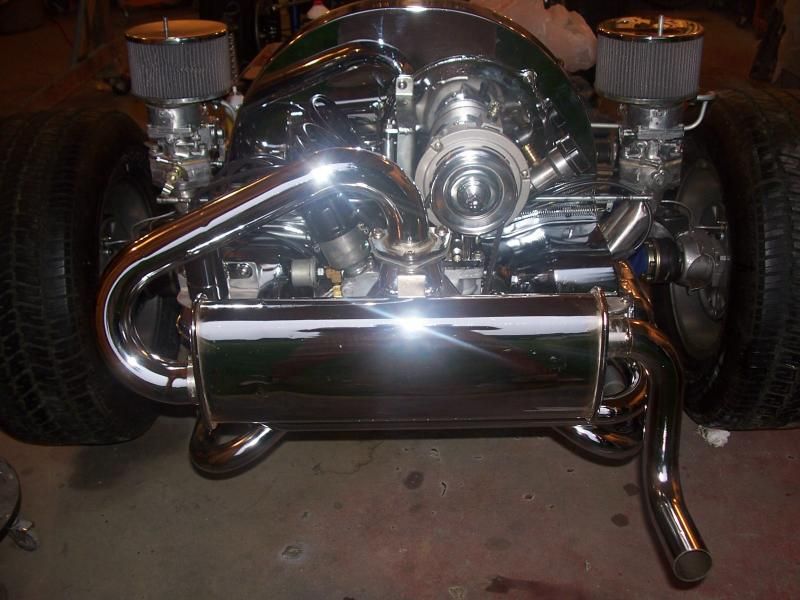

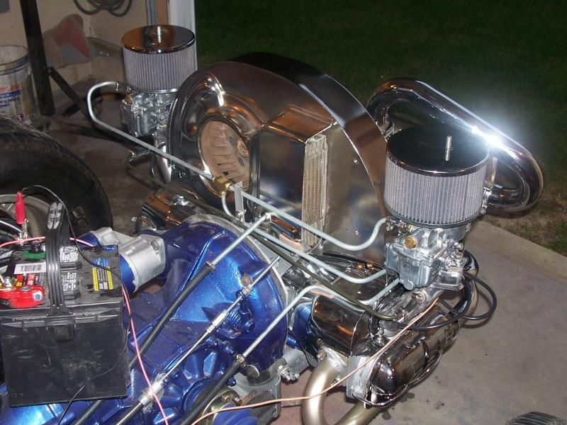

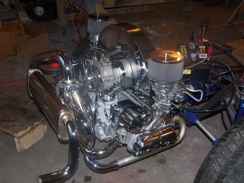

By Jeffrey P 655 Date 2013-09-01 00:04
Well It think my luck might be changing.
My machinist called to say my drums were done. When I got there I said "I hope they weren't too much of a pain.". He said "Nope, as soon as i scraped out all that paint that was inside they slide right in". $20 for his time. Got the drums home and all the wheels are now mounted.

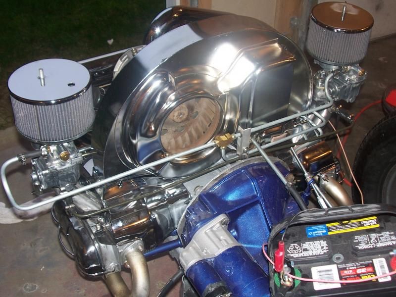

Worked on getting it fired today. Put some oil in, ballparked my timing, ran a temporary fuel source, hooked up the battery and ran a switch to my coil. Jumped the starter terminals and after about 10 minutes of playing with the timing and getting some fuel into the carbs and it fired right up.
It runs great! Not a single puff of smoke from it. If you recall I said that it looked brand new in there when I removed the heads so I did not split the case. It runs like new. I got the timing set and played a little with the kads. I had them adjusted a little too far so I took out some washers and I have a great stream when I jab the throttle. No flat spot.  It idled nice and smooth and is just fantastic! Someone is gonna get a nice little motor.
Here are some pics:
