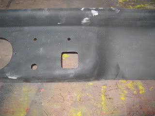

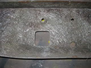

My next question I have is how far out from the edge of a hole should you then out. Here is a pic of my dash. I want to cover the whole where the old gas guage went. I also want to fill the hole where the gas tank filler was on my hood.

Ken might havea different idea (he usually does :-) ) but for smaller holes like what you have on the dash I would go about an inch.
Ken I should have posted in my earlier reply that I use 3 or 4 layers or glass mat on the back, not just do all the fill from the front. for the back I put a piece in the size of the hole, usually thick mat, to build it up, then a bit bigger one of woven mat, and then depending on the size of the hole one about and inch larger yet, for big holes such as a speaker or batter box hole 2 or even 3 inches beyond the hole again with woven mat.

Yea what Brad said hes allways right, LOL just kidding, but I do agree with him, I would grind around the edge of that size hole about 1/2 inch, and go out from the hole 1" to 1 1/2 inches out with the glass, you are going to grind off to get it flat and even anyway, leave a little room for a thin skim of body filler on the outside of the repair, you want even have to grind the glass you put on the back, you cant see it, unless you plan on putting a gauge in that area and you will want it the same thickness as the rest of the dash front and back, Brad they have epoxys now that high production shops use to bond on metal quarter panels, I am old fasioned and elect to keep on welding them on, You should be fine on the roof if you used a good epoxy SIMS etc, and for the proper operation, they have come a long way with epoxy over the years !!     Ken........  P.S what are you saying Brad I am backwards LOL.
