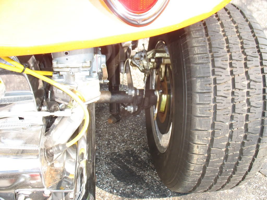

Ran great across town till one stop. At that corner the right rear disc brake stuck a little.
I thought since the rotors were a little rusty it would settle down.
Went on through the intersection driving fine.
Came to the next stop street and it locked up when I stopped and chattered really hard.
Okay so that a problem. No I am at a busy stop street but there is a parking lot in the next block.
I drive through the intersection to the parking lot dragging the right rear tire the whole way to get the buggy off the street. When I get out this is what I found.
I thank the lord that we were not on the interstate when she came apart. Had we made the Columbus trip last weekend we would have been driving around on the highway while up there.
Check you buggies often in between driving times folks. And be careful.

As much as I would like to blame the feverish build schedule for something like this, the fact remains, even when you build the entire car yourself with your own hands, (and have thus "nut and bolted" everything) things can go wrong.
John asked me to look at his steering at this year's MAM show. Why was the wheel so loose? Turns out the jam nut on the lash adjustment for the steering box had backed off. Its adjusted and tight now, but the point is, even parts on a component might be loose or not adjusted properly.
Hats off to you for getting it to the parking lot safely John.

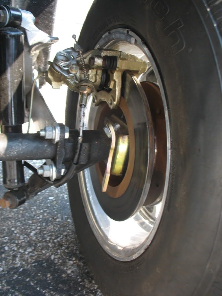

FYI, it looks as though the lower bolt backed out completely and allowed the caliper to move and twist. the twisting only affected the upper mount, so that indicates the lower bolt was not in/connected.
As far as the shock goes, if the nut and bolt are tight ("shanked out" where the nut is up against the shank of the bolt) and the shock isn't tight, something is not right there. Jerry caught a good one there. Either you have the wrong rear shocks (and the bottom bushing isn't long enough) or you have the wrong hardware.
Glad everyone is safe!

KYB shocks come with a spacer bushing that looks about as thick as the space in the photo.
Jerry....
By Jay H (X-20) (ManxVair CC) Date 2009-08-21 02:44
Hmmm, I can't tell if there is a spacer on the bolt or not. John, if you can't wiggle the shock side-to-side along the length of the bolt, then the bushing is probably installed.

On brakes there are 2 things that are your friend, Lock-tite RED and lock nuts. Check and make sure the caliper brackets are parallel to the rotor, mine weren't even close and it will cause poor performance, spongy pedal and vibration that can shake bolts loose. Another good idea is to throw all the cheap Chinese hardware in the trash and go out and buy good grade 8 or better nuts and bolts for everything you put on the car, especially for brakes and suspension or reuse the old German stuff.
I too "nut and bolt" my car every spring and did it after a 10 minute test drive and will again this weekend with about 30 miles on the car and I never do any highway or freeway driving for the first 100 miles or so, too many things could be missed, like the time I forgot to tighten the bolts for the front beam.....found that one in 10 minutes..........

And now I really fell dumb. It is all my fault even though we didn't lock tite anything during the build.
I was talking to a buddy about what happened and suddenly it hit me.
Over a  year ago when the buggy was at my friends house and we were making the wiring all neat and pretty, Jon had trouble moving the buggy in and out of the garage because the passenger side rotor was sticking. He told me the day I went over and picked it up that he had loosened the caliper mounting bolts to get it out of a bind.
I had completely forgotten about this until the other day.
I think Brad was exactly right on it. The caliper bracket was not perfectly formed on the passenger side.
This was causing the pads to  be forced into the rotor at an incorrect angle.
When Jon loosened the bracket it allowed them to settle down into the right place.
It was not a failure of the EMPI brakes, it was a failure on my part to remember that Jon told me to get the brakes fixed by someone before I drove the buggy. Mother @*&$#CX$#@!!!! I am just stupid sometimes.
