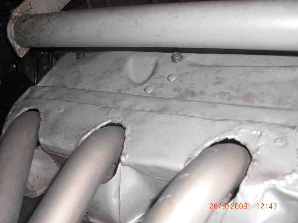

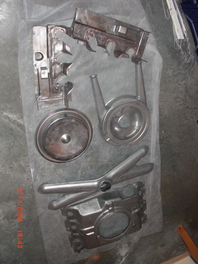

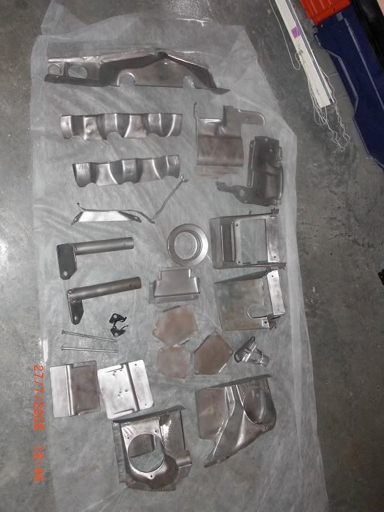

Here are a few shots of how I did the cooling tins around the buggy headers. It's been several years since I performed that work. I do remember that due to the shapes of the stock shrouds and the different curvatures of each header pipe it was labor intensive to clearance the shrouds to clear the headers without 'excessive' gaps. I tried to keep the clearance between shroud and header tube about 1/8 inch. I used (2) original Corvair shrouds to make each side so they slip together and are held by the stock bolts. I think I also burned a pair of junk tins as rough templates. Fortunately Corvair cooling tins are not rare around here. You can see where we built up some edges that had too much gap with a weld bead:
The bottom shrouds are at the top of this shot
The slip-in side tins are at the top of this shot, the modified for headers heater boxes are at the bottom:
I had the engine tins powdercoated, and had the headers jet coated. Both coatings held up well. I was concerned that the powdercoat would burn-off and the tins would start their rusting thing if they came in contact with the hot header, thus the extreme care taken in clearancing.
