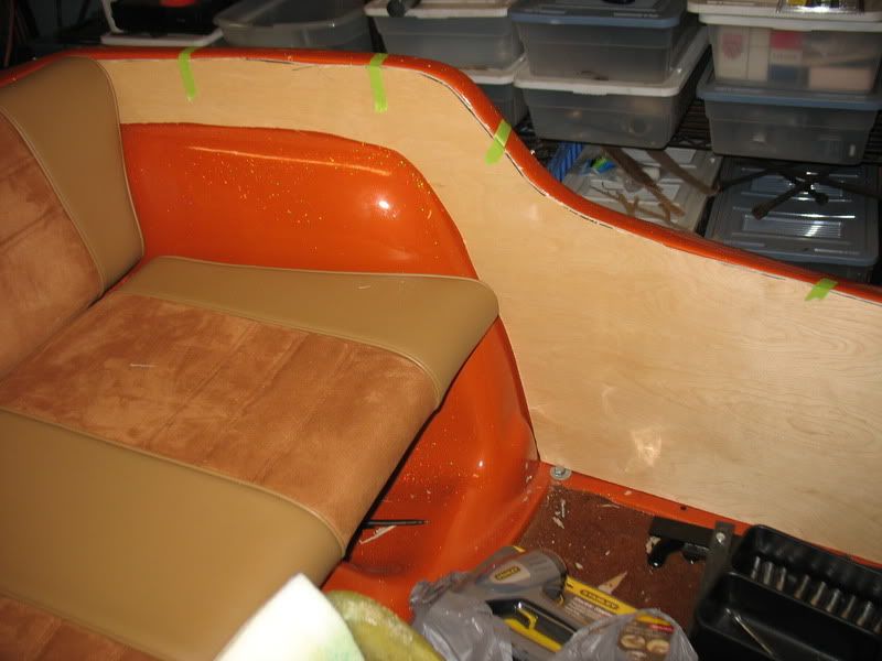

I pulled it out to mount the finished side panels this weekend.
I have neat trick for getting the roll bar in and out without scratching your paint.
Ratchet straps, I hooked them into the bottom of the tube snugged them in and
removed the roll bar by myself without a scratch.

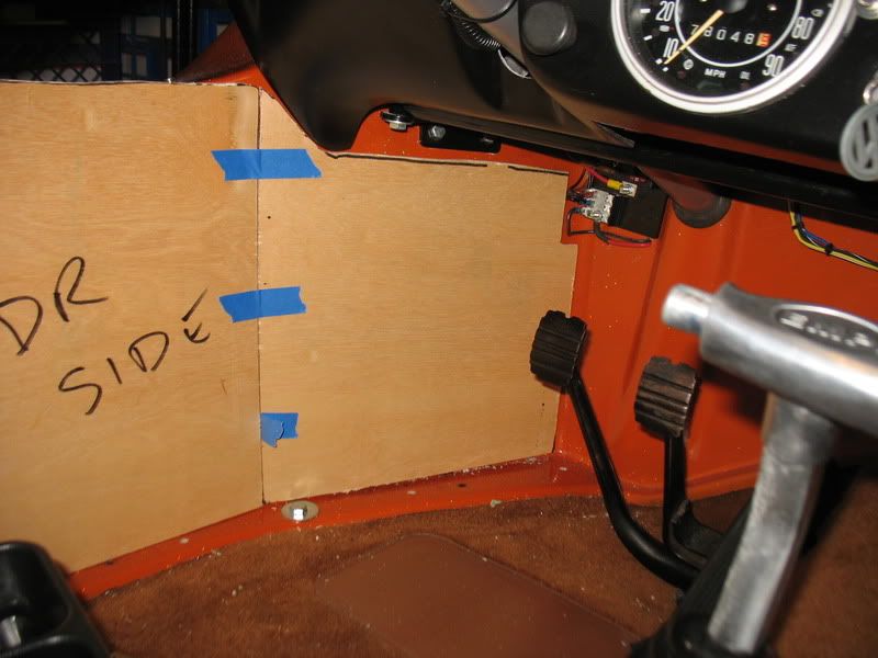

Make the side panel template was easier than I thought it would be, too.
Now we will see if I am any good at stapling upholstery.

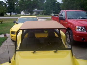

Also a question for Tom, do the Sombrero tops come in tan?
The black is kinda out of place with the tan carpet and upholstery.
I load some pics tomorrow.
By yellermanx y 25 Date 2009-05-07 11:24
Tan

By Kustoms Date 2009-05-12 21:56
Silicone the back sides and use cardboard tube to hold them in place overnight. No screws.

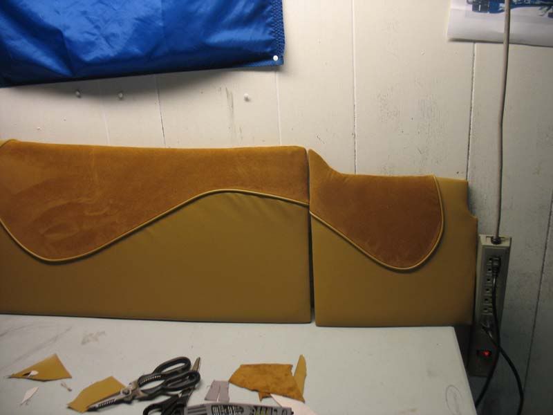

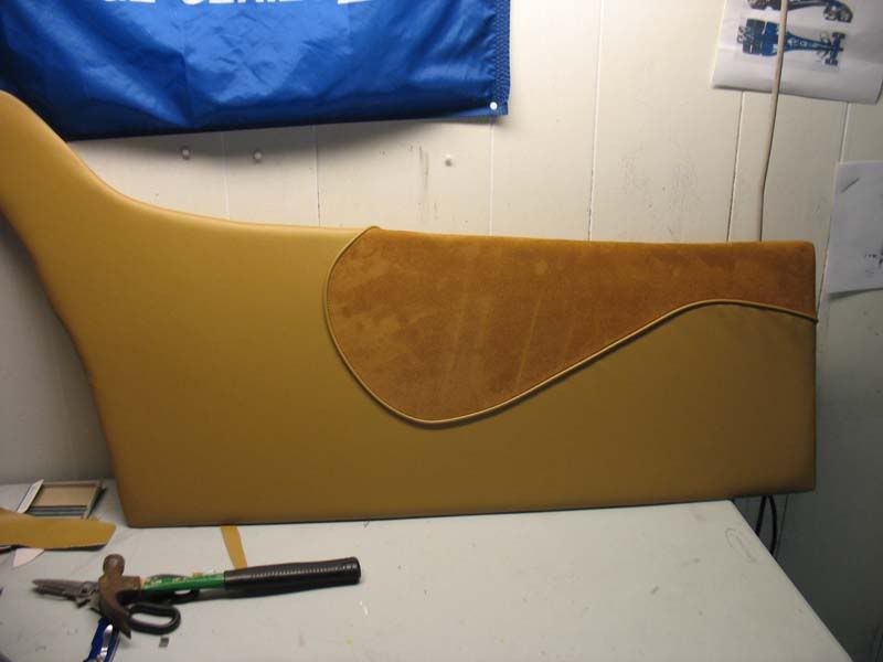

I got the panels built tonight and will get them installed tomorrow.
Here are some pics.
My first upholstery job. So be gentle with comments.
Had to get them done after 9 months of looking at it and wondering if I could do it.

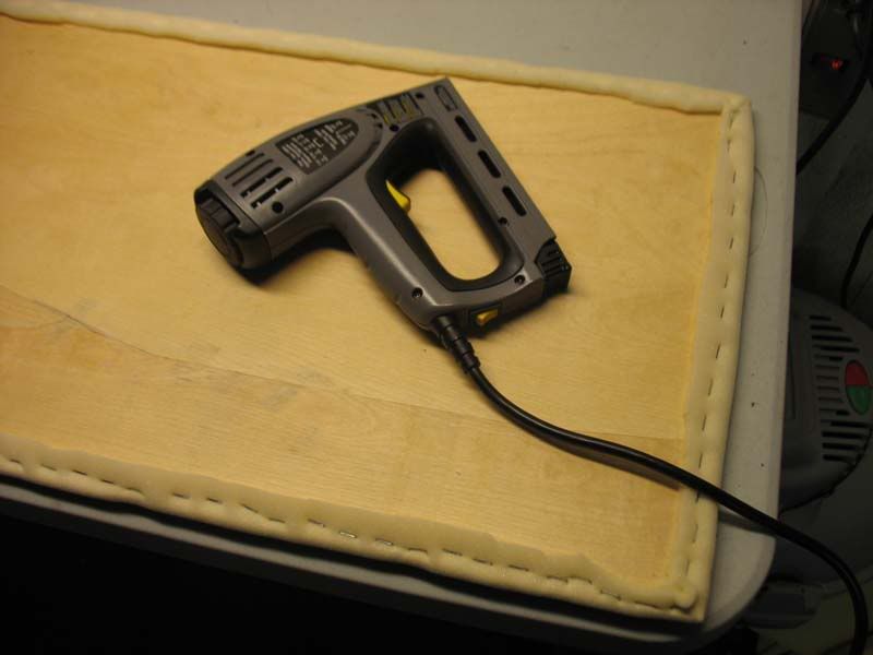

Back boards from 3 ply at Lowes one sheet .........$11.55
Foam from Pat's upholstery ................................$7.35
Stanley Stapler from Lowe's .............................$29.95
Finished Panels ..........................................Priceless. !!!!
