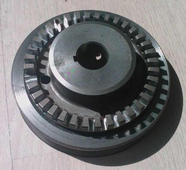

By Paul Moran (DBA Architect) Date 2008-03-24 21:50 Edited 2008-03-24 21:56
Jay and I are moving full steam ahead with the MegaSquirt/Subaru install.  The pulley is at the machine shop to have the rear pulley machined off, the rubber removed and the 36-1 teeth cut into the back section of the hub that would have been under the rear pulley.
The next challenge is where to locate the missing tooth on the pulley. Machining the teeth directly into the pulley will give little room for error so I'd really like to do this right the first time.
After looking at the 2002 WRX Subaru DOHC engine manual on page 189 for the crank picture, it appears that the woodruff key on the pulley matches up 180 degrees from cylinder #1 being at top dead center (TDC).
The diagram and text on the MegaSquirt ignition control manual shows the notch should be 9 teeth or 90 degrees AHEAD of the sensor. NOTE the diagram on the MS page is from "behind" the pulley!
With the #1 cylinder at TDC (I removed the #1 spark plug and put a section of rod gently up against the piston and rotated the engine clockwise from the pulley perspective until the piston stopped rising), the key slot in the crank was pointing to the right at 90 degrees - 3 o'clock position - exactly matching the diagram in the manual.
The sensor will sit at the noon position above the pulley.
Using the diagram from MSII (note, the diagram is from the perspective of being "behind" the pulley - the view the crank shaft would have if it had eyes), puts the missing notch exactly over the key in the crank shaft and pulley.
I'm going to attach a poor 3-D drawing of the notch in the pulley with the "missing notch" as the only part removed on the hub, (I'm not sure how to generate 36 cubes around the hub and then subtract them all from the hub in the program "Art of Illusion"...) - but I think it gives an idea of what it will look like in the end.
Picture 35 more teeth cut into the hub with one "tooth" already cut being the missing one in the 36-1 (36 minus 1) design and that one missing tooth lines up with the notch.
Can anyone verify that I have the positioning right?

By Paul Moran (DBA Architect) Date 2008-04-10 22:10
Machine work is done and this is what it looks like!
Its off to balancing next.  The funny extra holes I think were from the original balancing done by the factory. I can't think of any other reason they would be there.
By @Jeff GS Date 2008-04-10 23:18
Looks great Paul.
I think the holes are for the holding tool for loosening and tightening the attachment bolt.  That's what I used them for!
Oh wait - now I guess you're talking about the partially machined away holes in the teeth (after taking a 2nd look)?  Yea, probably balancing spots.
Jeff

Now for the challenge. When I crank the engine over, I see no RPM reading.  The MS2-Extra 36-2-2-2 Manual only talks about boards 2.2 and 3.0, not a v3.57 board.  I applied for membership to the MS forums, but have not been approved yet...
So from the crank sensor, the shield on the wire goes to the shield on the DIY cable (pin 2).  I hooked one of the crank sensor wires to the white wire inside the shielded wire (pin 24).  I hooked the other wire the the shielded ground.  Cranking produced no RPM.  I tried swapping the two wires and still see no RPMS.
Next I grounded the shielding (crank and MS shielding) and one of the 2 wires to the engine.  Other wire to the white wire, cranked, and I see no RPMs.  I flipped the 2 wires and still no RPMs.
I assume the crank sensor is a VR sensor (not a Hall) based on the description of a VR sensor in the MS manual and that DIY set it up for a VR, but can anyone else verify this?
I looked at how my LinkPlus is hooked to the crank sensor and one wire goes to the crank trigger wire, the shield goes right into the plug on the crank trigger.
Any ideas? Paul...

I may not have seen that specific post, but I did read about needing the correct edge (positive or negative) to trigger it.  That is why I tried switching the wires around.
There are some other interesting points in the post.  I'll have to check the board for pots, but it should be set up for VR already and it does see RPM with the JimStim set for the 36-2-2-2 wheel set up.

I did quickly try the MegaSquirt-II with the Extra code using the stock trigger wheel and VR sensor, but it would not register any RPM so I switched to the 36-1 back up wheel machined in the back of the pulley.  I reused the stock Subaru VR sensor.  I didn't have time to machine up a nice bracket like Jeff made, so I drilled 2 holes in a  small plate, spaced it with washers and bolted it on.   Jay later decreased the distance between the sensor and the trigger wheel so the RPM would stay stable.
So the sensors were all stock. The trigger wheel is a one time deal and wasn't that bad.  Of course, if your at OutFront, you should be able to get a good deal on a Stinger.
