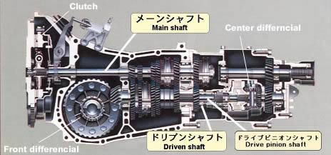

Hmmm... then again, looking at this picture I don't think the ring gear is "flippable" - looks to be a hypoid set-up (at least I think that's what its called?) - the ring and pinion are not aligned with each other.  I think this means that to move the ring gear to the other side would require a reverse cut ring and pinion, ie: not feesibly possible.
But flipping the whole trans upside down.... might be worth looking into.

On second thought, probably flipping the trans upside down might not be that great of an idea?  Looking at the above picture, even a very low oil level in the trans would have the input shaft submerged all the time, where-as in the normal orientation it probably isn't.  While the input shaft may seal OK for a while, I'm not sure that seal is designed to ride in a submerged fashion all the time?  I can imagine, in the normal orientation the gear oil mostly covers the ring and pinion gears and lower shaft, which is totally buried in the trans.
Pure speculation - until someone tries it and proves one way or another what works or doesn't.

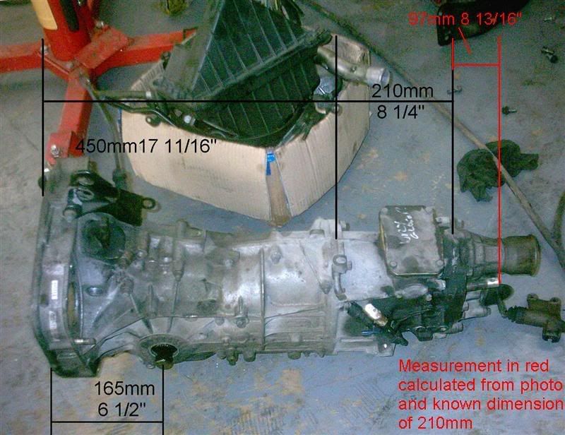

FWIW, a pic I have of a WRX trans showing some dimensions.  I'm not quite sure which portion at the rear gets removed for the Bramar conversion?  Just the tail portion?  That would help to shorten it up some.
Jeff

I think the biggest problem is the axis of the pinion shaft (if carried as an imaginary line through the ring gear carrier) doesn't fall on the axis of the ring gear.  They're offset from each other, and I think that's what make is a hypoid gearset.  In this case you'd need a reverse cut ring and pinion, and having followed some other transaxle discussions making such a gearset is a major undertaking.  Not that the equipment or expertise isn't out there, but the volume required for such specialty gears makes it a very expensive proposition.  The V8 Corvair guys have wanted such a gearset for years (decades?) but tooling up for it has always been too much $$$ for the relatively small volume required to meet the demand.
Jeff

Does anyone have a pic of the shortened Subi box or have the diamension ?
Would like to compare it to a VW box for length and fitting it in as a tail drager
By Mel Adjusted Date 2008-02-17 04:43 Edited 2008-02-17 22:16
If you wait till tomarrow I'll get a tape measure and measure a Subaru transmission and one of you VW boys will have to measure a VW trans.
As promised... From the bellhousing ti the backing plate it's 26 1/2"... Thats for a converted transmission.. Now one of you guys with a VW transmission measure them and post it here

By dunelimo Date 2008-02-18 04:52
A bus 2 liter 091 box is 22'' long end to end but not counting the nose/shiftrod part that sticks out
