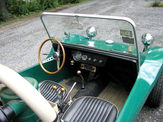

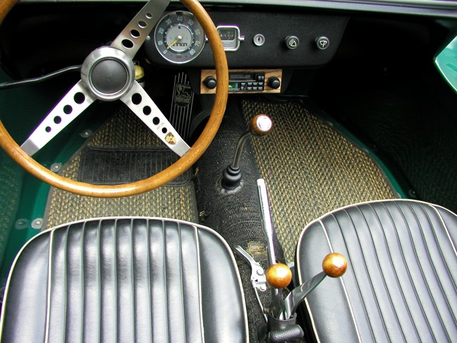

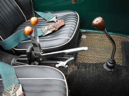

Here is a picture of a set that was in a vintage Manx that Randy Carlson bought from the original builder.
Knobs on chrome stalks that were pull operated.

My favorite....check out the gas pedal too....
By FarmerJohn Date 2008-03-08 13:09
that is one sweet lookin ride
that"s the type of turning brake I'm speaking about
anybody know if they are still made ?

By michael c 3832 Date 2017-02-26 12:48
I know this thread is old, but - Yes, the sets that are flush with the ebrake handle are original meyers manx cable operated turning brakes.  You push down to stop each wheel independently.
Terribly difficult to find.
