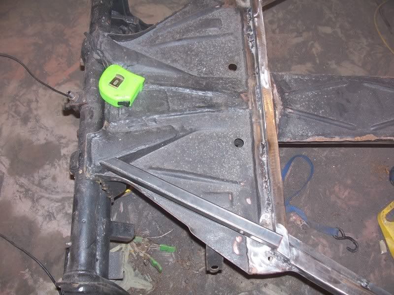

I've never used angle iron for the floor so Jeffery will have to help you . As far as the dip for the pedals. I just shaved a bit off of the tabs on the pedals, kept the floor flat and welded in my pedal stop. On your build I would get the floor set in place and see how much clearnace you need. If you are using checker plate, you might be able to grind a bit off the pedals and notch the floor and bolt in your pedal stop.
By Jeffrey P 655 Date 2011-12-20 14:56
It won't break going down the road Tom...what you have there is probably 10 times stronger than the factory pans. Do the old bounce test....before you cut the pans out put all your weight on them and bounce up and down. Do the same thing after they are repaired...you will see what I mean.
For the angle I basically just transfer a level line from the tunnel lip across the span to the outer frame rail. That inner lip on the tunnel is your reference point.
I hope you are going to modify the rear lip. You really,,,really,,,need to.
For the pedal indent you can make a little clearance with a hammer and also clearance the bottom of the pedal cluster. A little combination of both will get you where you need to be.

     As far as the angle iron goes, one last question. It seems to me, at this point, it would be easier to attach the angle iron to the 1x2 box before I install the box tubing. Would make it easier and less time spent in the cold of the build sight and easier here in my lab where I have access to some cutting and forming tools. Do you know of any reason why I shouldn't do this now?

Make sure you coat that inside rust with something while you have it all opened up. You can use some POR15 but I have also just used some rust converter spray to help keep it at bay. My reasoning is that it has only rusted that amount in 40 years while basically untreated so anything more should extend it beyond your lifetime.
By Thomas B 2944 Date 2011-12-30 00:16
Hi Jeff,
     Happy holidays. I was thinking of doing the POR 15 thing but was concerned with it catching fire as I weld the tunnel cut outs back. I thought that I could get into it almost as well afterwards through the front, pedal and shifter holes and again through the back. Maybe I am out to lunch and concerned about fires to much??
     Also, while your here, which way did you face the 3/4" angle iron? I have been looking a various builds but can't seem to make out the direction of the "lip". Should the edge that lays against the tunnel be up or down? Hard to get the positioning across with words but you most likely understand what I am asking.
     Have you had a chance to work on your build during this Christmas season?
Tom
By Jeffrey P 655 Date 2011-12-30 03:00
I am right in the same spot as you are. I just wish I would remember the camera when I go out.
For the lip I take a small level and a section of stock and go from the tunnel lip out toward the frame rail. The bottom of the stock (which is resting on the tunnel lip) will be the top of the frame rail lip.
Once you see where the lip should rest you can decide how to mount the angle. Usually it is applied like an "L" and not a "7" if that makes sense.
Be sure you give some thought to the rear section. You have the stock piece that comes from the tunnel on an angle down to the outer frame rail mounting point. You need to complete that triangle with a pice of stock that goes from the outer frame rail to the inside of the tunnel horizontally.
The way I place it is to find a perpendicular line from the top of the angle section down to the floor. That imaginary point will be the outer rear most edge of the piece you need to weld in (I use 1" square stock from Lowes or HD). The top of this piece should be flush with your frame rail angle and meet up flush with your modified rear lip on the tunnel.  Imagine a flat surface starting on the tunnel lip, going rearward to where that angle piece comes from the tunnel to the outer rail mount, across the rear section, and onto the frame rail angle.
You can then weld (or rivet some diamondplate like I did) into this little triangle area. The florr will sit on the top of this 1" square stock and the rear section will rivet to the back side of it.
Confusing? I can try to get some pics if you like.
If your concerned with the fire you can always spray the inside down with some water (since it will have the POR15 on it anyways) to keep the fire risk down. I personally don't think its huge. Haven't had one yet burn my shop down (knock on wood!)

     When you weld the two sections of angle iron onto the side of the tunnel, do (you) weld it on using tack welds or do you use longer sections of weld? This past weekend I managed to attach one of the angle Irons on with tack welds, as many as 20 on the top and as many on the bottom. Should I go back and weld in longer sections? Seems very solid at this point, do not want to overkill.
     From looking at the photos that you posted, the tunnel must of been deformed a slight amount as is mine and hence the reason for the plastic. I had an added dent in the lower section of the tunnel.  Is the need for the plastic normal? I had to use the oxy/act to weld the two sections, top and bottom tunnel, back together and this may have added to the deformation. The tunnel was very thin in the area of the joint where I ground the lip off, not rust but most likely the way the two sections were stamped at the factory leaving a rounded edge. I could control the heat much easier with the torch than with the welder. Back to old school techniques. I would of like to have used the welder but could not seem to set it low enough to keep it from burning through. My skill level is most likely having a great deal to do with my inability to control heat with the welder.
     Hope you have had time to work on your buggy.
Tom
By Jeffrey P 655 Date 2012-01-10 16:28
I just use little 1" stich welds every 4-6" or so on the top and bottom to hold mine in. In my opinion that is plenty. I also weld up the relief cuts I make it them for the bends,
I actually am just about done with mine too.
I used plastic on my tunnel to give it a better shape since it was not being covered by carpeting. It was purely for details. I will be doing the same with this one. The tunnel has a whole bunch of factory dents and such and I fill them all in to give the tunnel a very smooth and finished look.
Its just my style...its not needed.

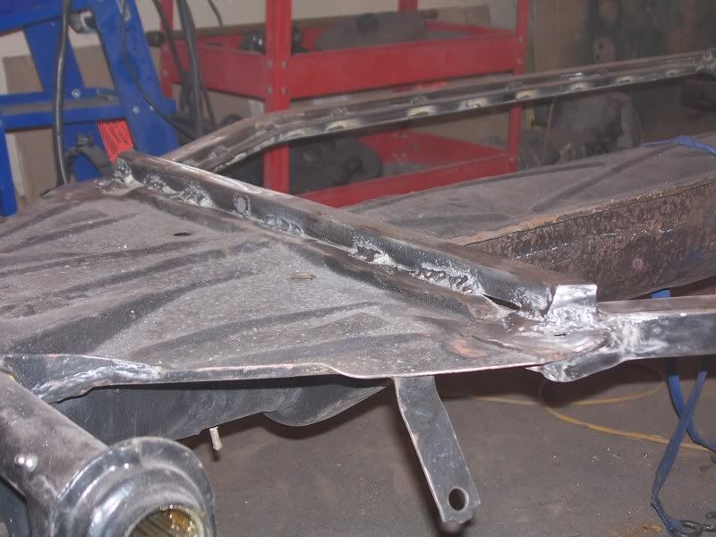

     I have been working on the buggy and thinking at the same time. I will be attaching the rails that I fabricated earlier and am studying/thinking about how each end will be attacked. On "Napoleon's hat end it seems to me that I will need to shape the end, cut it, to fit the "boss" that protrudes back. This would allow the top and sides of the rail to pass over the boss and align with the angular section of Napoleon's hat.
     The rear section, I am still trying to think about the strength and how it should be shaped. Should the top and outer edge lap over the old belly pan edge? Should I remove the outer section of belly pan and weld directly to the reinforcement bracket underneath?

By Thomas B 2944 Date 2012-01-22 03:04
Hi Brian,
     After the first few post I asked about that exact thing. I do not want to upset anyone out there, I appreciate all that has been shared with me so far from the "Buggy Bunch" here on the DBA. I have no idea how to to switch to the "Buggy Build Showcase" so if anyone would like to do that for me I would not object.
     Thanks for commenting on the build. I should have some more pictures soon but the cold weather takes its toll on me. It seems to be my age. I do not have a garage here at the house so a good friend of mine has graciously offered a section of space in his old chicken barn. I have it closed off, somewhat, but the space heater works continuously to just take the chill off. My feet take the cold the worst I have found. It is, however, very nice to be able to work on it during the winter months, even just the amount that I can.
     I started to fit the rails today.

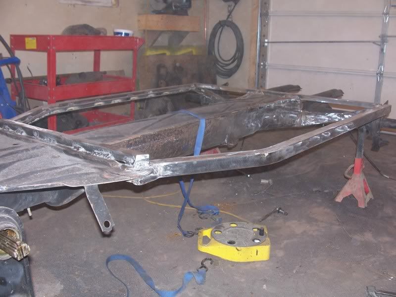

     Today I finished fitting the rails and tacking them in. Still need to "test fit" the body then I can finish the welding. The tunnel still has one section cut out so that I can treat the inside with rust inhibitor. Some pictures will show where I have used brazing to repair rusted sections. As I am still learning to flux core weld, I felt better dealing with the rust with the torch. Most of the brazing is at the the front and only in the non-supportive areas. The head frame really is in very good shape.
     I have been watching Jeff and Brad's build, as well as a few others, trying to glean construction tips, and have come to the conclusion that each build is truly an individual build, with all their varying circumstances and problems to work through. I can only hope that my adaptive solutions will stand the tests of time.

By Jeffrey P 655 Date 2012-02-20 14:17
Tom,
It looks great. You have got it all figured out for sure. and yes...the best part about these builds is they are always unique. Don't be afraid to explore new solutions.
Just as a reminder for you as you progress (and only cause it popped out in a picture)....you want to make sure you don't forget the 2 tube spacers that go inside the front bulkhead for the master cylinder bolt holes.
You don't need them now...but you don't want to forget them either.

By Thomas B 2944 Date 2012-10-16 00:48
Hello from Maine,
     I have been away for quite some time, this time, sorry. I hope those that have been giving me help and encouragement are still willing and don't feel that this is just another one of those partially finished, got in over their head, builds.
     When I retired in the spring I knew that I was facing surgery soon but had no idea that it would be as soon as it was. I am still on BLT restrictions, for at least the next 6 weeks but have been trying to get some things done that only require a little amount of Bending, Lifting and Twisting. My kids have been helping out with any of that. Let's just say that "speed" is just not in my vocabulary at this point. Baby steps is better than no steps.
     Before I went in for surgery I manage to get the tunnel finished and the PORS15 applied. Rust was starting to form again from the humidity of the summer months. I was in such a hurry to get it coated that I didn't think of taking pictures but if you look at Jeff's posted picture of his tunnel you will get the same as mine would have been. I was so tired of filling dents by the time I got done.
     Last week I managed to find the time to make the patterns for the diamond plate installation. I used poster type cardboard which I cut the shapes for each section then taped them together to make the full pattern. I call this my linoleum floor trick. When I was quite young my mother hired a local carpenter to lay a new floor in our small bathroom. The bathroom was so small that he could not just lay the flooring out and cut around the fixtures so he cut the contours out in small sections using large paper, then taped them together as he proceeded along. When he was finished he just laid his full size pattern on the linoleum and cut it out. I thought that it was such a nice trick I never forgot it. $$$$$$$ saved.
      Next I laid out the pattern on the underside of the aluminum diamond plate. Noting left and right, top and bottom. I then taped it in place securely to keep it from creeping the during the cutting operation. Using my jig saw and a metal cutting blade I cut carefully along the edge of the pattern. Patience is the name of the game here. I did note this, as I was cutting I noticed that the saw cut quicker when I was cutting through the tape used to hold the pattern down. Maybe someone out there can give me an explanation for that???? Be sure to re-tape after the saw passes by to prevent the pattern from moving. Low and behold the floor fit first time and I only had to make a very small adjustment to be able to use the same pattern on the other side. That side also fit first time.
     I am in hopes to rivet the floor boards and make the end plates sometime this week. Tomorrow I will be cleaning the trans-axle to getting it ready for paint.
Tom
