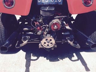

By Dave C 4367 Date 2015-06-03 01:48
No not 6 and change. I paid $9200. If you go on youtube and search "StacyandDee Dune buggy" you'll see the four or so videos of the build. The one for 6 and change got away from me, thats another story. LOL
Attachment: Blueberrymotor5.JPG (476.8k)
Attachment: Blueberry105.JPG (478.3k)
Attachment: Blueberry13.JPG (461.7k)
Attachment: Blueberry10.JPG (542.7k)

Very nice looking buggy Dave, its definitely a $9200 buggy one of the nicer ones I've seen.
