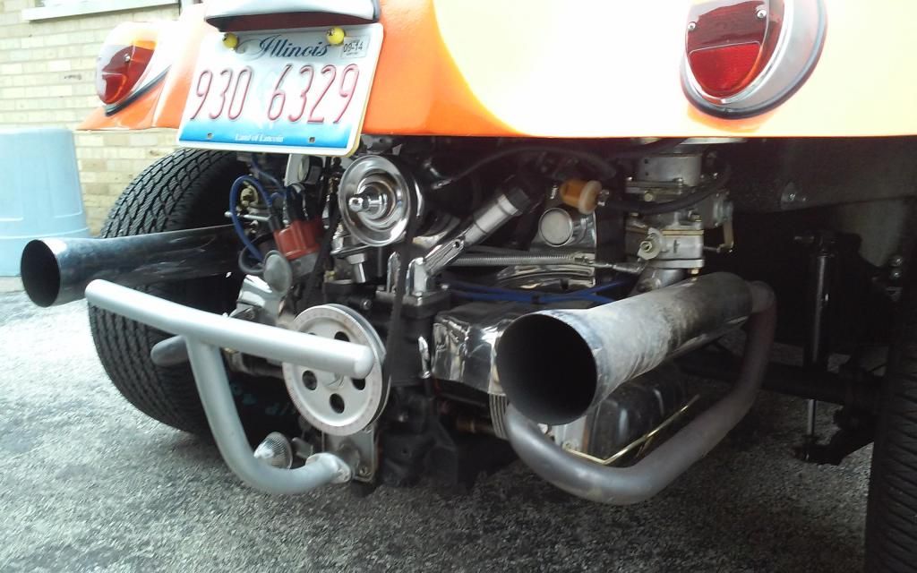

Hello everyone, bought this project a few years ago on ebay after selling my Chris craft boat I rebuilt. I'm a Chevy guy so thought this would be a snap.  At first it was a nightmare!!!!! It was sold to me as a 73 but nothing fit when I started buying parts and fitting them on.  It is actually a 1963. I told the wife I was just gonna do a brake job and tune up to get it running. As you can see it was a very expensive brake job! Lol. I replaced the floor pans, all new brake and fuel lines(European flares on the brake lines thats why they were all leaking when I double flared then like Chevy ones), new suspension, aluminum axle beam, chrome and polished stainless everything. New tank (had to move the filler neck on the tank) and new motor a 1915cc. New wiring and you get the point. I stripped the body (originally orange metalflake) and helped with the body work (a friend sprayed it) silver base with heavy metal flake, house of color candy tangrine metallic and clear with pearl in it. Best thing about the whole project it was done 100% (besides the spraying) by myself! I checked the buggy id and could not find the manufactor maybe some one could help me. I live in chicago and want to go to berrian buggy in Michigan to see if one of their tops will fit it, I think it will be a great addition to the bug. Photo bucket number I think?

1st. The buggy is BEAUTIFUL
2nd. As ingenious as that rear nerf bar is, I would be in fear that one parking lot tap would be detrimental to the function of the oil pump

Agreed! That is just asking for trouble. As is the plastic fuel filter.

I would concern myself with oil flow now. Welding warps metal, I would thing the oil pump could be having problems now. All though it looks cool, I would make a new mount for that nerf bar.
